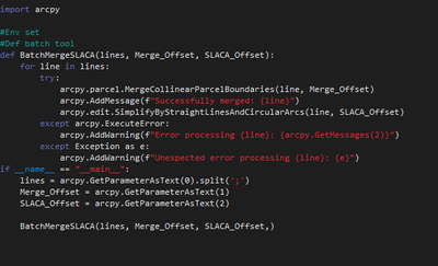

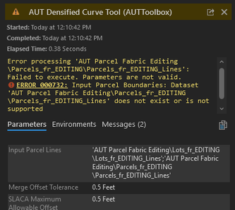

I have developed a quick little python tool that combines the Merge Collinear Boundaries and the SLACA geoprocessing tools. This tool works fine on a copy of our PF data saved to my hard drive. Though when I try to use this tool on my versioned PF data I keep getting this error.
I hope this is just a parameter I need to adjust to get the tool to identify the versioned PF, but kinda at a loss as to what I need to adjust. As of now, my parameters for my input layers are set to "Feature Layer".
Here is my script being used and my parameter settings for context.
Our PF data is hosted on SQL Server and published through our enterprise.
I am sure there is a parameter or line of code I am missing to get this to work. I appreciate any tips to get this working!
