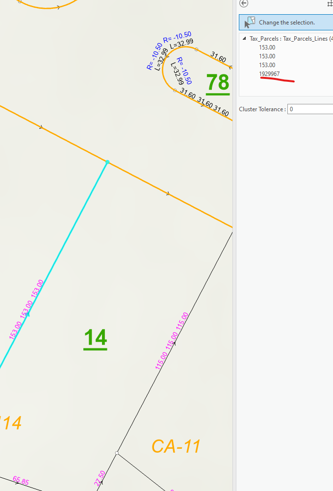

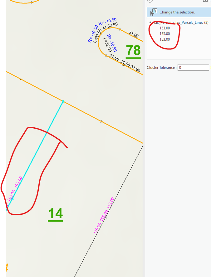

I have upgraded to 3.2 to check some new features out.  The problem I am having is that in the past if there are duplicate lines, I have been able to select and Planarize, but now when I se planarize in the location of a duplicate parcel line it is creating a new line.  The problem is when I draw in a subdivision I run planarize on my lines. So now I have a subdivision full of duplicate lines. Below I have already done it twice  and now I have three lines.
After I planarize
new line created

I worked with tech support because the planarize tool wouldn't complete in 3.2. Two bugs were logged. Try removing COGO attributes and rerunning the tool.
Planarize tool runs indefinitely if lines features' COGO attributes are populated- BUG-000164836
Planarize tool doesn't delete coincident line segments- BUG-000164803
AmirBar-Maor
@Wade_Cherry
Thanks @AliciaTompkins for sharing the BUGs you have logged. They occur with ArcGIS Pro 3.2 and when using feature services. We are working to fix them in ArcGIS pro 3.3 and intend to patch 3.2 with those fixes.
