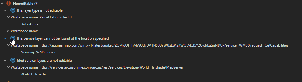

I'm quite frustrated. We regularly georeference old plats onto our map to aid in the reconstruction of parcels in an area. A recurring issue that I have had ever since switching to the ArcGIS Pro parcel fabric is that after you have georeferenced something, the parcel fabric will randomly lose the ability to edit. I get the following message when trying to move any parcel feature.
If you check the status window, it reports no issues.
Even more strange is the fact that while it says the layer is uneditable, you can prove that it IS EDITABLE by going to the feature and changing an attribute and saving it. The attribute change is saved with no issue. The only problem is when trying to move a feature.

I can confirm, at least in my case, that it is 100% related to georeferencing. Here was my workflow that just reproduced the issue.
1. Add .tif to map
2. On the imagery tab, started a georeferencing session
3. On the georeference tab, fit it to display and then started adding control points.
4. When all required control points are in, I can still freely move the points as needed. But the second I save the georeference, all points become un-editable with the move tool.
5. As you said, restarting fixes the issue, but if do a new georeference, the same thing happens every single time. The only way around it is to either not save the georeference, or to save and restart every time.
To sum it up, the error does not occur for me until I have saved a georeference session. After doing so, I have to restart the project every time.
