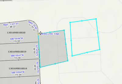

Can you try moving the yellow moving symbol the area of the moving feature you want to snap?
Here's an example.  I've selected all the lines and points of this feature, right clicked and chose MOVE
The yellow dot appears in the center
Now holding down the CTRL key and clicking on the yellow dot you can now move it around
I've now moved it to the corner of the moving features
Click and holding on the yellow dot I am now moving the feature and it will snap to other features in the map.
Hopefully this answers your question! If not feel free to clarify anything.
