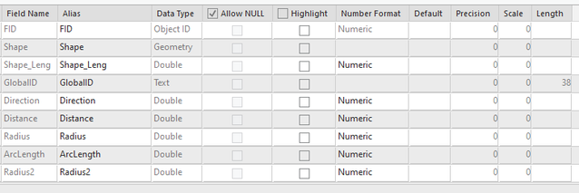

The below image show the fields and formats of COGO attributes in ArcMap.

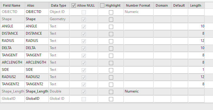

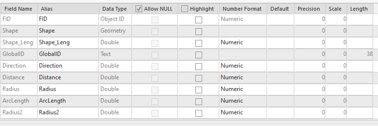

I have exported a COGO template to be used in ArcGIS Pro as shown below.

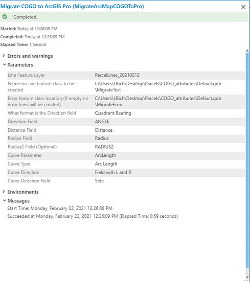

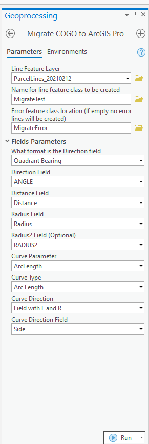

Can you send some screenshots of the entire tool after it's successful run?
Thanks,
Jason Camerano
LinR
Hi Jason,
Thank you for the immediate response and help on this. I am glad to be able to reach you. Yes, it doesn't create a feature class after I ran the tool.
Here are the screenshots:
JasonCamerano
Given the fact that it took 1second to run, it looks like nothing was created.  How many lines are in your line feature class?  Would you be able to send me a sample of it?  [email protected]

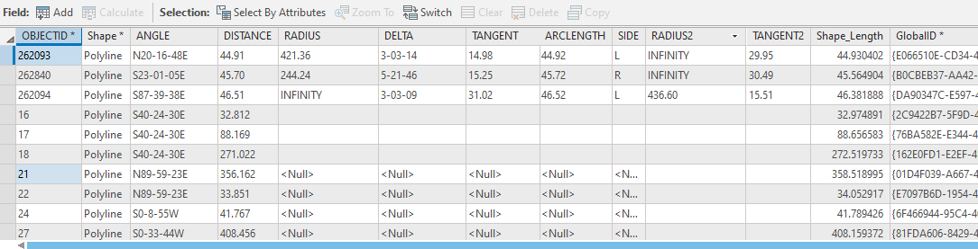

I have 267,331 lines for the complete dataset. Here is a set of sample data.
