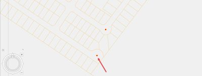

I am attempting to convince the survey coordinator (Sr. Management) that it is important for us to align our Parcel Geometries with the imagery on delivery, and in order to do that Coordinates that we can use for LSA would be useful. Typically, Eagleview utilizes items such as sidewalk curbs which will not help us at all. I have identified visible cul-de-sac centerpoint monuments throughout the County that I am more than willing to create a more visible target for them (example below) for these as they will need to do this in parts of the County where there are no cul-de-sacs and they would prefer to minimize the number of times that will be necessary.

Regarding the painted locations for the centers of cul-de-sacs. The painted /surveyed locations used for the photo-control could serve double-duty as a tie-in to the parcel boundaries if there is a physical marker in the asphalt (iron pipe or similar) that can be positively identified as the "true" (in parcel boundary sense) center of the cul-de-sac, and that is what gets painted/surveyed.

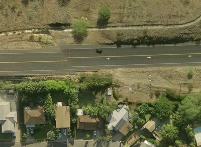

We had attempted to use NGS point references as as POB from the documents in ArcMap PF, and it wasn't terribly accurate over time. Part of the reason is that for each imagery delivery there are 'shifts' in the delivery; by which I mean that with each new mosaic the appearance of the image for each tile was slightly different that the last version making it appear that the POB destination wasn't aligned correctly (one), and there are what we have somewhat affectionately called 'schizms' that are located in different places with each delivery (two-see attached example).
We are intending to attempt the method you have described above and hope that helps in conjunction with the certified orthomosaic and True-Touch upgrade.
