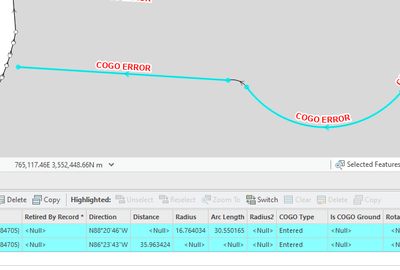

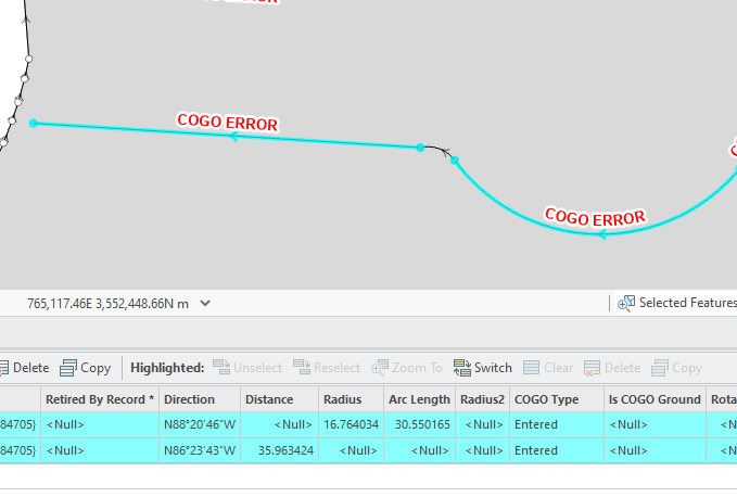

I have a parcel fabric where the COGO field values are in meters.  I'm able to modify the Default COGO label expression: var cogo_distance = $feature.Distance * 3.28084;
Which gives me the proper label in feet.  However, for lines with values in the ArcLength field, the COGO ERROR label shows.  When I attempt to change the variable in the default COGO expression to the following:
var cogo_arclength = $feature.ArcLength * 3.28084;
I get COGO ERROR labels on all lines.

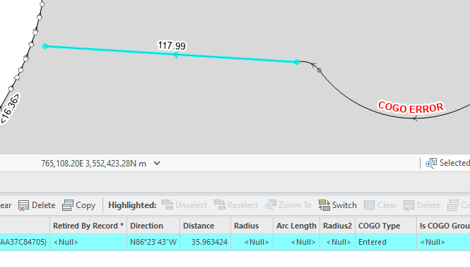

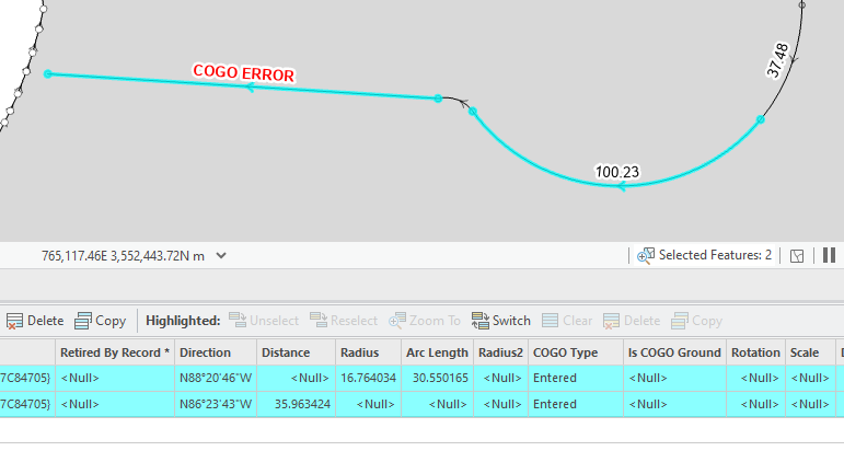

If I take off the conversion for the Distance field, the ArcLength shows properly, but of course the Distance field shows the COGO ERROR.
Can anyone help point out where I need to further modify the expression to get both fields to show properly in feet?
Thanks,
Robert.
Pro ver. 3.3.1
geodatabase is fgdb
Parcel Fabric ver. 5

AmirBar-Maor
Hello @RobertChaney
A "COGO Error" is returned when there are too many parameters. For example, if Direction, Distance, and Radius are all populated.
It looks like the conversion is placing a zero ('0') if the original value is NULL, instead of keeping it empty.
This can be solved by checking and only converting the units if the attribute is not empty:
if (!IsEmpty($feature.Distance)) cogo_distance = cogo_distance*3.28084;
Add this check for any value that you convert (distance, radius, arclength, radius2)
Please let us know if this solves the issue
