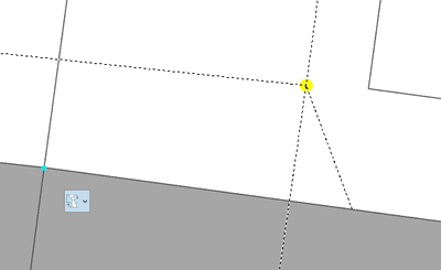

Hi All,

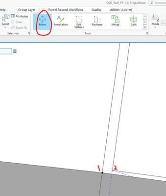

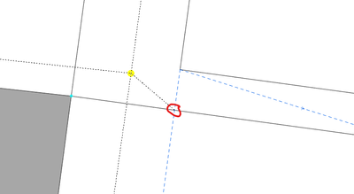

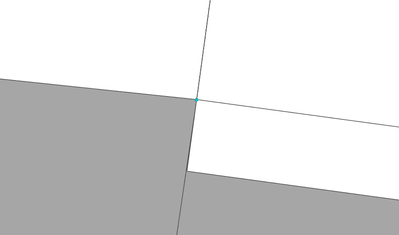

I'm trying to use the Move tool to use the Parcel Fabric geodatabase default topology rules to move the existing connected parcels onto my new traversed work (moving point 1 to 2 in snip below). When I attempt this, there is an invisible anchor that holds the horizontal road parcel in place. The connection lines seem to create extra vertices at the location it crosses adjacent parcels and for both their lines and polygons. After deleting the vertices off both these, still the connection line seems to anchor down on the lines that it crosses and not allow the move to occur. How can this be stopped? Connection lines out to Survey Control are always going to pass over adjacent parcels in our fabric, but we still need to be able to use the Move tool to fit exiting parcels to new plotted work. Any feedback appreciated, thanks! 🙂
Zoomed in and trying to move point 1 to 2:
Result:
Snip of line that is anchored to where dashed connection line crosses it:
