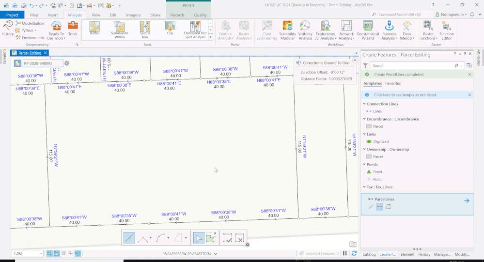

Subdivision entry efficiency - you are making an interesting statement and we would like to look into it. Are you aware that you can override the attribute values and digitize 2-point lines for repetitive lot lines as shown below?
Entering and editing in ArcGIS Pro is much more efficient. Should we setup time to meet and understand where you see additional deficiencies?
