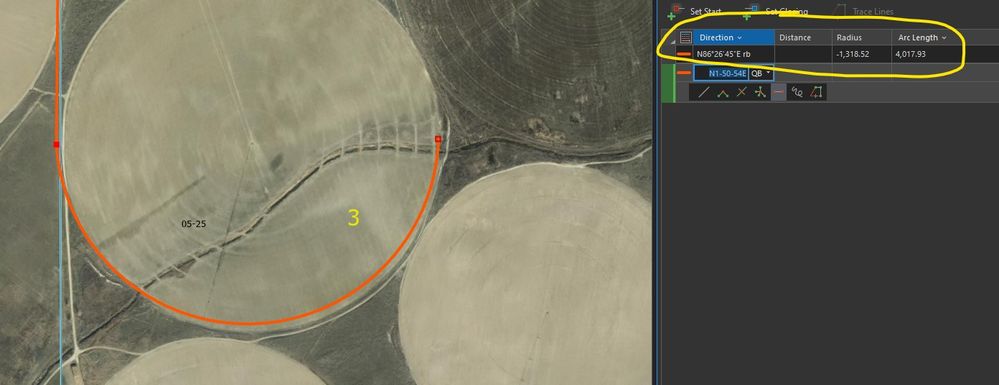

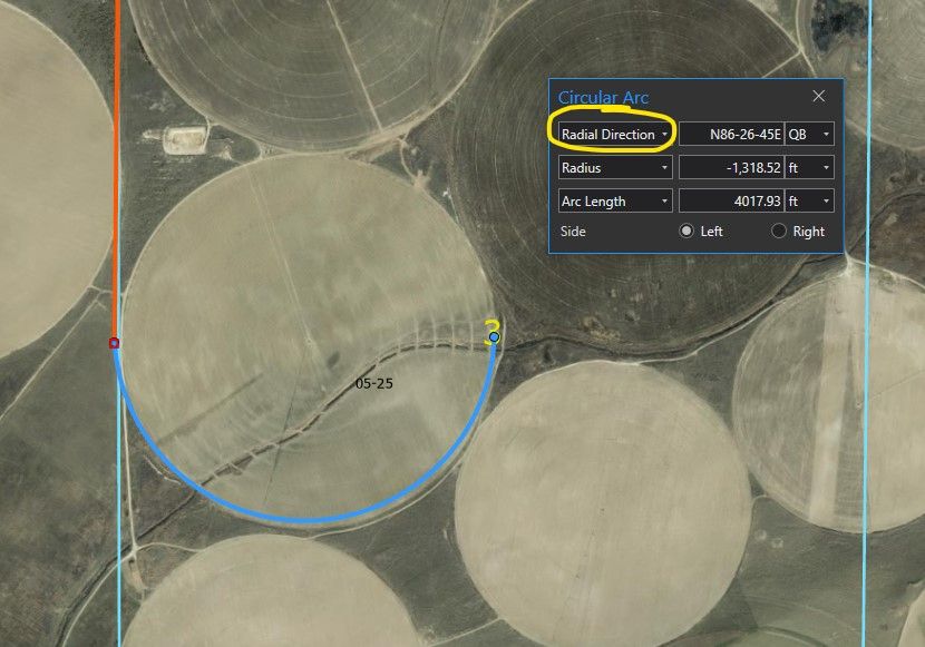

by Anonymous User
Not applicable
Excellent! It looks like that did the trick! - Can you confirm 'Radial Direction' is the option I need to change?. I didn't see a rb option.Screenshot 2022-07-16 073554.jpg
jcarlson
MVP Alum
Sorry, the "rb" thing is if you are using the Traverse tool (look in the Modify Features panel). It is fantastic for entering legal descriptions, if you've not used it before.
Using the "Circular Arc" tool, "Radial Direction" is what you want, yes.

by Anonymous User
Not applicable
I always use traverse for straight lines and circular arc for curves. I think I got it now using your method in Traverse.
