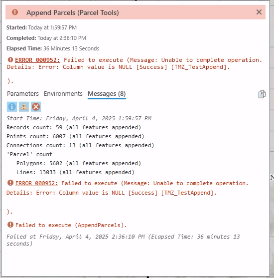

While attempting to append a smaller parcel fabric into my larger versioned enterprise parcel fabric I am running into an error preventing the append parcels tool from completing. The tool got to 91% complete and was working the records when it failed. I've looked through the attribute table and haven't found any unexpected NULL values. Has anyone run into this before or have any ideas what may be causing this?

The 000952 error is a 'catch all' type of error, making it hard to know the cause.
You can try to select a subset of the data and see if it works - that will indicate that this is data specific.
FWIW - we had a similar error with the geoeprocessing Import Parcel Fabric Points when importing fixed points.
I recommend opening a tech support case so we can have a look into it.

Thanks @AmirBar-Maor. We ended up using a round about process with some field calcs and a series of standard appends to get the data appended. Hopefully this will be my last time using the copy/append process now that we're setup in enterprise.
