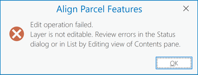

I am doing a align parcels in our Pro fabric.  I get this error after I have generated links:
It still does the align.

Did you check your editing status?
Could you please ensure your links, anchor points, parcel fabric points, and the parcel being adjusted are all editable?

That was the issue, needed to turn more layers on as editable and as selectable.
Tough getting used to the new methods in the pro fabric.
