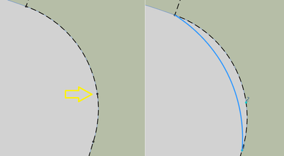

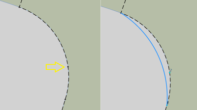

However, this does not work on curve segments that are one overall arc segment in the real world boundary, yet with some botched input data conditions, there is densified features, such that when you merge points.

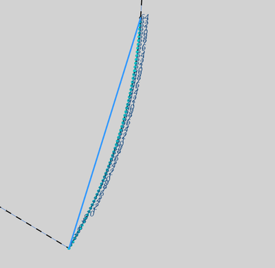

In the below screengrab, I have a curve with a series of 64 densified points and straight segments.  I'm suggesting for the Merge Points Dialog, there should be a checkbox parameter built into the merge points dialog to "recognize curve geometry" so as not to "buckle' the curve geometry to a straight segment (blue line below)
In some cases, we'll simply identify just one point along a curve that doesn't belong there that we want to flush out by merging it with the curve's 'true' endpoint.  Yet the problem is that the geometry of the curve, itself outputs with weakened spatial integrity where the radius is compromised.

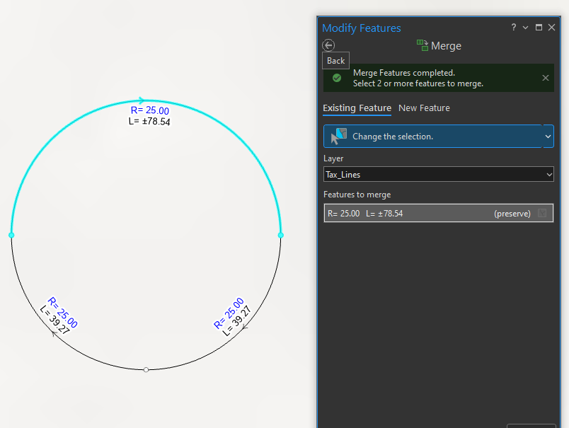

Are you trying to merge two curves into one feature + eliminate the point between them?
If yes try this:
  1. Make sure you have an active record, preferably of the record that created the curve.
  2. select the curves you want to merge
  3. Launce the merge tool and merge into 'Existing Feature'
Before Merge:
After Merge:
