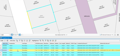

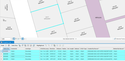

When currently using the tool on a historic parcel, it will select the following lines (since they are active):

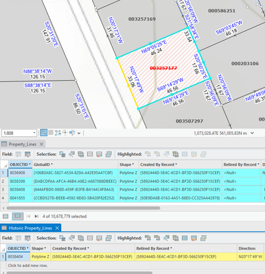

We would like to see it select all of the following lines (historic and active) – the first image is how we’d like to see it when historic and active lines are all in the same layer in Pro, the second image is how we’d like to see it when using the default view of the parcel fabric where historic features are separated from active features:
