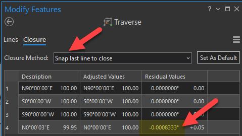

If it is really important you can still review it by switching to the CLOSURE tab and setting the Closure method to 'Snap last line to close'. The last course shows the misclose direction and distance.

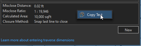

You can copy past the misclose information by right-clicking in the traverse misclose area and pressing 'Copy text'. Most organizations do not use this functionality because it is already stored as a parcel attribute that can be used for QA (Quality Assurance).

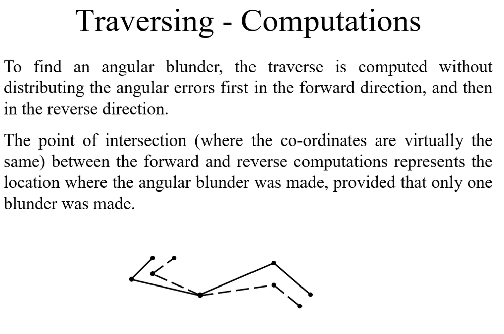

There are a few methods to try and detect blunders in a traverse as described in this slide deck.
It is also possible to detect a single-direction blunder in a closed traverse using this method:
Would improving blunder detection in the traverse pane make more sense than exposing additional information?

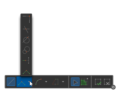

The directional information is standard surveying info as well as a standard practice.   If I have to contact the PLS of record due to an error, the misclosure distance and direction are expected.   If I cannot do this in ArcPro, I'll be forced to use AutoCAD or another traverse software.    In fact, there other functions that ArcPro does not have that even ArcInfo had that helped when trying to deal with non-tangent curve errors:  bearing\bearing, bearing\distance and distance\distance intersections.  Those are invaluable functions.
AmirBar-Maor
Hello @RachelBaca
You will find the command you refer to in the editing toolbar. Those are 'intersection tools' and you can learn more about them in the help documentation.
