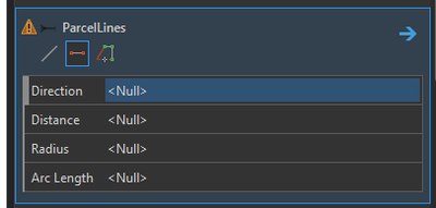

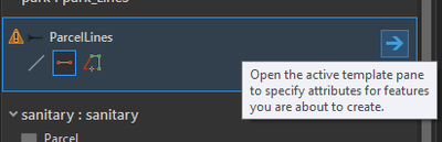

I know that any feature template can be "stepped into", like so:

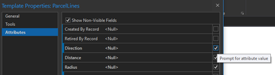

But I also know that any feature template can be edited to prompt for specific attributes:
In my editing workflows, I find it much more convenient to have the 4 most common COGO attributes (distance, direction, radius, arc length) available as prompts.

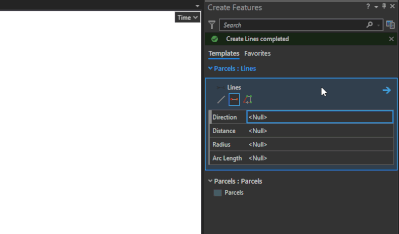

Here's me utilizing the prompts:

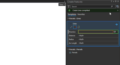

And here's me just ignoring them:
I am in no way inconvenienced by the prompts being present, but for manually entering COGO values, having them at hand on the feature template is a big time-saver. Interim lines and lines which have their COGO entered / calculated by other means would not be affected by this change, I don't think.
