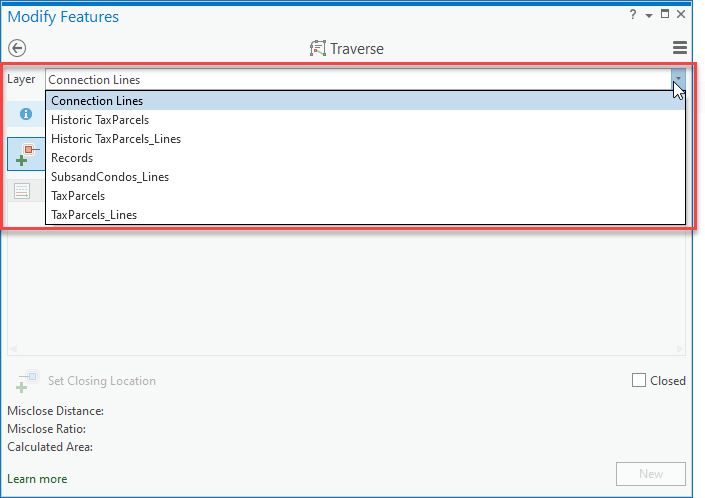

Good day.   Could you help me to understand your request?  With the traverse tool you pick which layer receives the COGO lines (See screen snapshot below)
How are you entering the different line layers?

In Pro, every line is saved as a feature, so you do not have to save TXT files to save your edits. You can also modify a traverse by tracing it and can isolate to a specific record using the 'Show Only Active Record' button.
As for the idea, a traverse is imported to the line layer that is set in the traverse pane. If you want to have additional attributes maintained, It would be better to export features to a file geodatabase and then append them: any matching fields and values will be appended.
