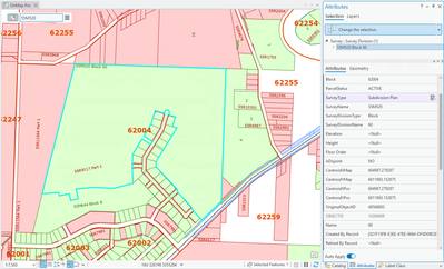

Our organization provides authoritative parcel data in Ontario to hundreds of downstream clients. We are requesting an enhancement to the Clip geoprocessing tool so that, when used on Parcel Fabric features, it provides a toggle or parameter to control which Record the remainder parcel is assigned to (either the remainder’s original Record or the new Record being created).

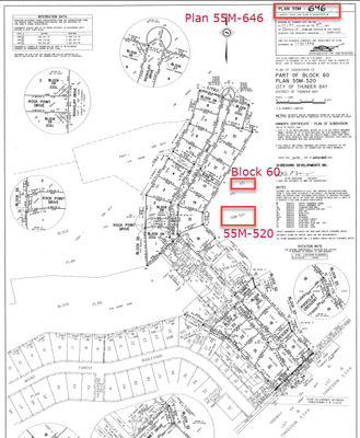

As an example, in Ontario, survey plans frequently involve subdividing part of an existing block. When a new subdivision plan clips out a portion of a larger parent block, the portion removed is assigned to the new plan/record, but the remainder parcel (the portion of the block that has not been impacted by the newly integrated subdivision plan) must retain its association with its original Record.
Example Case:
A new subdivision plan (55M-646) supersedes/clips a portion of Block 60, Plan 55M-520.
The clipped portion becomes new subdivision lots under 55M-646.
The remainder portion of Block 60 must remain under Plan 55M-520, and the description for the plan would be updated as “Block 60, save and except 55M-646”.
Without a remainder assignment option, editors must manually fix the record assignment, creating additional steps and room for errors. As attribute rules will also be in place in the environment, this will also involve additional attribution cleanup triggered by the traditional assignment functionality of the Clip tool.
