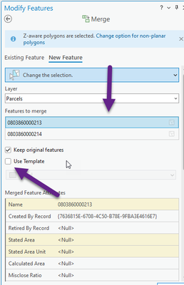

JasonCamerano
Hello @CatherineRoloson
I think what you want to be able to do with Merging into New Feature can be done.  If you uncheck the "Use Template" check box and then you can choose which feature to preserve the attributes by selecting the feature in the "Feature to merge" box.
Let me know if this is what you want to have happen.
-Jason
CatherineRoloson
Wow, @JasonCamerano that's a sneaky fix !
We've tested this on our end and it did exactly what we were hoping for which is marking the two original parcels as historic and creating the new parcel with the attributes of the one we selected.
Thank you so much for your prompt response. This worked like a charm.
