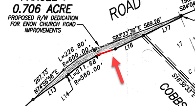

For example:
There is a missing course  in this location
But I assume you are used to that reality in VA.

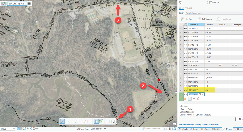

When you use parcel fabric lines to enter the data, you can switch to digitizing mode which allows you to enter natural boundaries by digitizing them. You can even prepare different boundary line types to distinguish between natural boundaries, road frontage, side lots lines etc.

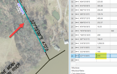

I decided to start with Parcel A with the point marked as '1', encountered a missing course marked as point '2', and never reached the water with the course of 470' (+/-) marked as '3'.
Maybe the course going to the river should have been 870' instead of 470'?
You can see in the screenshot about that when you use lines to enter the traverse:
  1. Your edits are saved as individual features - making it easy to stop, save edits and return to it at a later time.
  2. Labels show you the COGO attributes you have entered - making it easy to compare to the georeferenced dimensions on the plat.
  3. You can switch to digitising mode for natural boundaries.
  4. You can maintain different boundary line types, which have an impact on zoning.

The missing course between L14 and L16 is L15 from the table. I am sorry that the label on that was invisible on what I scanned. Your instinct to pursue Parcel A was correct. That is the one I am working with.
Composite plats are famously terrible regarding accuracy for the +/- distances that negatively impact closures. I do account for that when finalizing these types of boundaries, and how much faith we put into the accuracy. I'd consider this a step up from a tax map polygon at best. Nevertheless, it's helpful to have a better reference than nothing at all. I have seen typos and mis-keys like you are guessing on for the 470 versus 870. I may be able to find the plat for the shared line to see if that's the case here.
