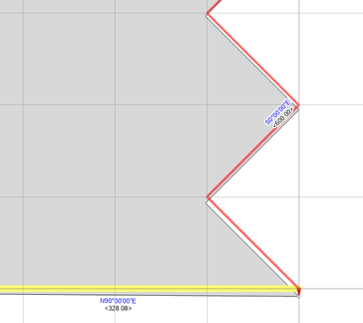

LSA strectches the natural boundaries to the new point location as you can see here.
Before:
After applying LSA (red is the original location):
That means that if you run LSA and then use Build Extent, the calculated area will change from the "original" area.
