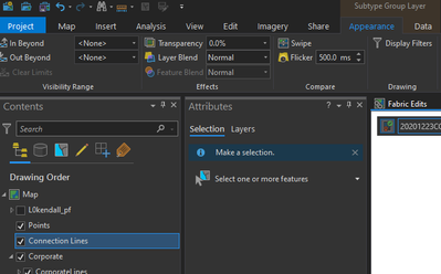

I added subtypes to our Points and Connection Lines, in order to enforce certain domains and attribute rules. When I add the fabric service to a new map, it brings in the Point and Connection Line subtype group layers, but with no subtype layers in them.
I can use the Add Preset Subtype Group Layer tool to bring it in after, but certain Parcel Fabric tools, such as "Merge Points", will not recognize the subtype group layers as a valid points layer.

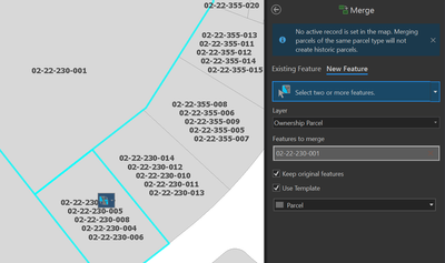

As to the Merge Points issue, perhaps at least getting the tool to recognize the subtypes as valid points layers would be enough. Again, looking at parcel subtypes as an example, if I attempt to use the Merge tool on two parcels of different subtypes, the tool merely prompts me which layer I am trying to use the tool in, but does not allow merging across subtypes.
Something similar in the Merge Points tool would be ideal, I think.
Currently, here's what I see when I try to use the tool on a point subtype layer:
