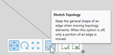

The methodology you describe with the Move tool also requires the "Stretch Topology" button to be turned on. For parcel boundaries this would (likely?) always be necessary.
