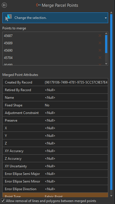

Merge Parcel Points remains one of my favorite tools. Even after fairly extensive cleaning, our cadastral data was extremely messy when it was imported into a Pro Parcel Fabric. If I could do it over again, I'd have spent a few more weeks trying to clean things first, but we're too far down the road now.
Cleaning up some of our over-noded / densified boundaries has been made unspeakably easier with the addition of the Merge Parcel Points tool.
I do have slight tweak I'd like to see, however, and that's the size of the "points to merge" list. It's currently about 4.5 items tall. The "merged point attributes" list, however, is extremely tall!
With very few exceptions, I don't find myself changing many of the attributes upon merging points. If I do, it's simple enough from the Attributes pane itself.
Often, however, I am selecting a large number of points. In messy areas (hydro boundaries, densified curves, etc) I may have a selection into the double digits.
Having the option to make that list longer, or even hiding/collapsing the attributes altogether, would make my life a lot easier!

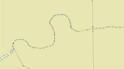

1.
We have a lot of points mostly because we went straight from a topology-enabled feature dataset to the Pro fabric, and said dataset was handed off to us from the prior staff without our fully understanding all of its ins and outs. We found out later that said staff weren't even using the topology tools, so many of our points ended up being multiple points that were slightly offset.
We created our parcel features from various polygon layers, and we didn't realize that many of these had densified segments. I don't just mean curves (those were mostly fixed prior to import), but even straight road frontages that, per their respective deeds/plats, ought to be a single two-point line, might have a large number of vertices along the line.
There are also cases where a parcel appears to follow a creek centerline, and from what I can tell, prior staff must have traced a hydro lines layer to create the boundary, leaving behind dozens, in some cases hundreds, of vertices along a section of boundary that might have only required a handful of curves and vertices.
All this meant that the vertices along these parcels got converted to fabric points, with two-point lines between them. Here's a screenshot I had handy (though this is not even close to the worst we've seen).
Legally speaking, this boundary should be a single line with a distance, no bearing.Legally speaking, this boundary should be a single line with a distance, no bearing.
Add to all that the fact that we did this all when the Pro Parcel Fabric was v1, and certain tools (notably Simplify by Straight Lines and Circular Arcs) were unavailable at the time. Like I said, I'd do things differently if I had to import into the parcel fabric all over again, but we're already a ways down the road of actually using the fabric, so we're just cleaning things up as we go.
Fixing areas like this isn't too bad, but some alignment tools won't work, as some of the tiny lines would be collapsed into zero-length features, or the points would be snapped to being overlapping. Merge Points is amazing for this kind of work, allowing me to simplify the boundary to a single edge, from which point I can use ReshapeEdit Vertices, etc., to create the correct boundary shape.

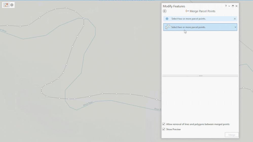

@jcarlson
Here is a sneak peek into the enhancement planned for Pro 3.0:
1. Point labels makes it easier to know which point is which
2. A new splitter lets you resize the point selection area versus the area showing the attributes of preserved point.
AmirBar-Maor
Status changed to: Implemented
With Pro 3.0 you can resize the selected point area.
The displayed points use incremental values from '1' instead of ObjectIDs. Those values are also displayed in the map which makes it easier to decide which point to preserve.
