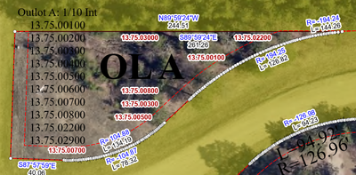

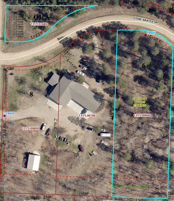

Sorry for the thread necro, but we've only been using the Pro Fabric for a little over a year now and I just stumbled on this issue.
In our situation, we have several "shared interest" tax parcels across our county, especially in plats.  While there is typically a "parent" parcel number, we have copies of the geometry associated with the each shared parcel occupying the same space.  The purpose for this is to assist the department that handles land transfers so there's a visual representation of a parcel (and associated pieces) on the main county web map (see picture below).
So last week I was doing some cleanup work on parcel boundary curves that were left over when we converted from the ArcMap fabric a year ago.  As I don't want to be creating historical records for this work, I was using the Shrink to Seeds / Reconstruct from Seeds method, outside of a record.  Everything went well until I went to expand the seeds in this particular area (see picture below).  Ultimately had to abandon 2-3 hours worth of cleanup work because I couldn't figure a solution at that point in time as to why it wasn't expanding.  Figured out the whole, "expand one seed at time" trick, but there are some areas in the county that have 30+ associated tax parcels stacked up, and I'd rather not have to manually manipulate each seed every single time I need to make any edit.
