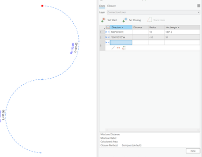

AmirBar-Maor
@JeffWard
In this example, using ArcGIS Pro 3.3,  the curve entry was changed from 'Delta Angle' to 'Arc Length'. Both values reflect the data as it was entered. This allows the user to compare the entered data to the entries in the traverse grid.
Did we solve the problem? or are you asking for a 'refresh' button to show you the values in a certain way = Delta Angle, chord, Arc Length? Couldn't that just be a label expression that shows all 3 for any curve?
