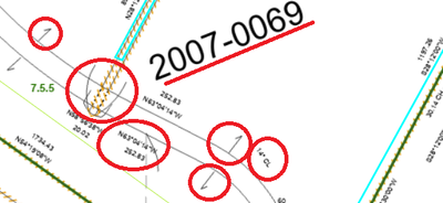

To Be Clear - I am referring to a point, line and annotation feature classes that are used for cartographic purposes to assist in replicating a record.  The following diagram illustrates some of these features (highlighted in red).  I our redesign to Pro/Fabric and review of business practices these features remain as annotation and lines (I hope this helps describe what I am talking about).
