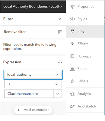

If you add the WFS to the Map Viewer, you should be able to use the Filter tool.  Here is an illustration:
Have you tried the above?
Miguel

For the WFS, in the Map Viewer, are you using the correct syntax for the CQL_FILTER?
Here is an example that works for me:
If this is an Esri WFS, I'm afraid that, as far as I know, these do not support CQL_FILTER.
