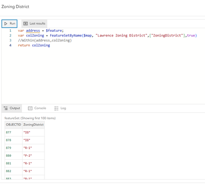

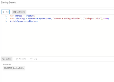

Is there a trick to using the Within function when referencing a layer in a multi-layer feature layer? I used a simple Within function to add the intersecting parcel PIN number to an address point's pop-up, but when I try to get its zoning, here's what happens:
If I comment out the Within function and just tell it to return all zoning data, it works:

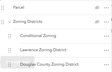

The difference between my parcel feature layer and my zoning feature layer is that the zoning layer has three layers in it:
The FeatureSetByName function doesn't seem to care that it's in a group, but maybe Within does?
I did try adding the Lawrence Zoning District sublayer by itself to the map, but I got the same results.

I've used your layers in a map and it works as expected. The code I'm using is
var fs = FeatureSetByName($map, "Lawrence Zoning District", ["ZoningDistrict"]);
var WithinFS = Within($feature, fs);
iif(
  Count(WithinFS) == 0,
  "Not in a zoning district.",
  First(WithinFS).ZoningDistrict
which returns this when run in the text editor (using iif to return a message if there are no features returned by the Within)
and this in the popup ("R-2", circled in red)

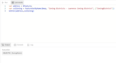

Hi @AmyRoust,
So the within function returns a feature set of the features that fall within the specified layer. If you have an instance where some layers may overlap others then what I might suggest is any of the following.
var FS = FeatureSetByName($map, 'Zoning Districts - Lawrence Zoning District',['ZoningDistrict'],True)
var Address = $feature
if( TypeOf(Geometry($feature)) == 'Polygon' ){ Address = Centroid($feature) }
var AddrWithin = Within(address,FS)
iif( Count(AddrWithin)>0, AddrWithin, 'No features are within the layer')
Note: the intersects function can also be used if the input layer is a point feature.
AmyRoust
@RPGIS - no luck, but I appreciate the suggestion.

It doesn't matter if you have the layer within a group layer. This works on a test I set up.

Did you test the code on an actual feature in the Zoning District? Running the code in the editor will use the first feature in the FeatureSet, which may or may not give you a feature within the Zoning District layer. You can use a feature you know will work by filtering the parcel to a specific one. In my example, I can filter the earthquakes to a specific event to test it out.
This code
var feat = First(Filter($layer, "id = 'mb90114598'"))
var fs = FeatureSetByName($map, "USA Census States")
var output = Within(feat,FS)
return output
return {
	type : 'text',
	text : first(output).STATE_NAME
returns this
The code in your latest post fails because you're supplying an incorrect name for the FeatureSetByName function, which returns a null. When used in the WIthin function, it's being interpreted as a null feature in the Geometry Within function (which returns a boolean) instead of the FeatureSet Within function (which returns a FeatureSet)

Correct me if I am wrong but it might appear that @AmyRoust is referencing a grouped layer which, if it is setup correctly, should be a single service in which case the Within function should work. However, if it is created as separate feature services which are then grouped in the map then that would require a different work around. In which case @AmyRoust could try one of the following below.

@RPGIS your first assumption is correct - all three layers are published as one service. I only need to pull the intersecting value from the Lawrence Zoning District layer, but it wouldn't hurt to pull the value from the Conditional Zoning layer. Either way, neither Within() nor Intersects() works with the zoning service. It does work with our parcel service.
The parcel service just has one layer, which is what led me to suspect that the multi-layer service was the issue for me. I took that exact block of code in the screenshot above and just swapped out parcel for zoning, and it returns an error.
@KenBuja you asked, "Did you test the code on an actual feature in the Zoning District?" Yes, I did try that. No luck.
iif(
AmyRoust
@KenBuja - that worked! Looks like adding First() is what I needed. Seems odd to me that it didn't need that function for the parcel layer, but perhaps there is some overlapping geometry in the zoning that I need to find.
