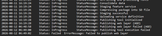

Publishing and exporting hosted feature layers fails (ArcGIS Pro and AGOL browser), including minimal test data and simple schemas.

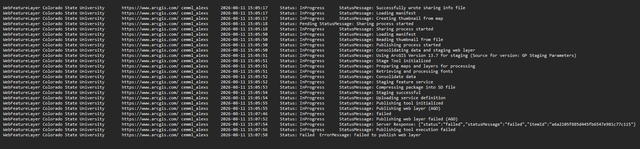

Pro logs show staging succeeds, SD upload starts, then publish fails with generic failed status. Often it will just stall out at "uploading service definition" in ArcGIS Pro.

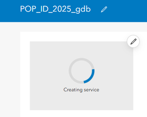

Attempting to publish to AGOL through a browser also stalls out.

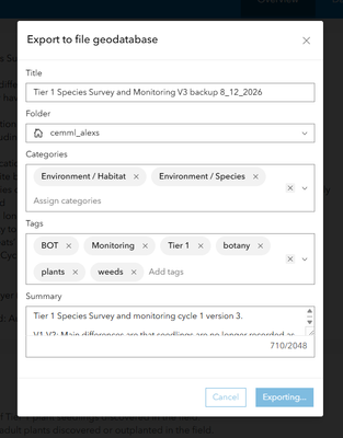

Additionally, any Export to file Geodatabase in AGOL or Export Features in Pro will not complete after hours of sitting at "Exporting" in AGOL or "100%" in Pro.

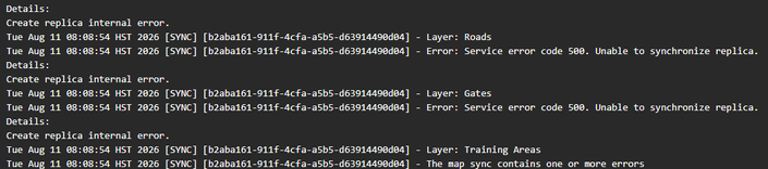

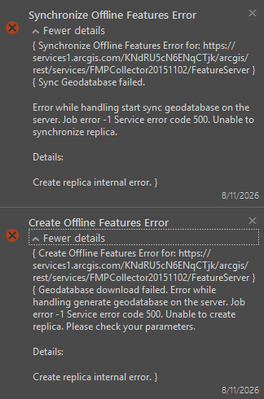

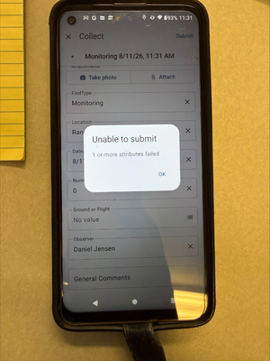

Offline area creation and sync fail across multiple hosted layers (ArcGIS Pro + Field Maps).
Errors include: internal replica errors, inability to create/sync replica, HTTP 500, ERROR 004005, ERROR 004547. These errors are more common in our org but usually they can be resolved.Screenshot 2026-08-12 065919.png

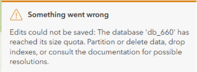

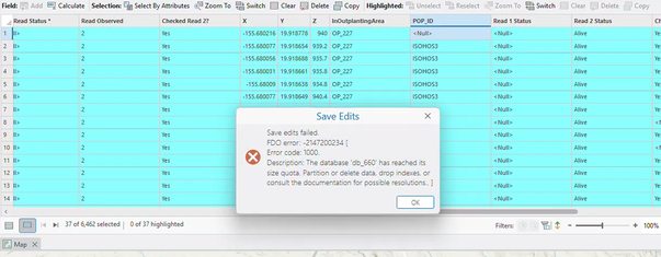

This coincides with an error that we've never encountered before related to "The database ʻdb_660ʻ has reached its size quota. Partition or delete data, drop indexes, or consult the documentation for possible resolutions.
We've now encountered this on multiple projects over the last two days and have successfully removed enough replicas to allow edits and clear this issue BUT we still cannot manage to taking those maps offline.
