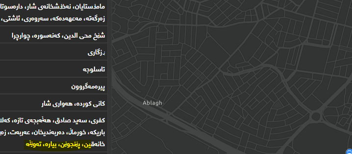

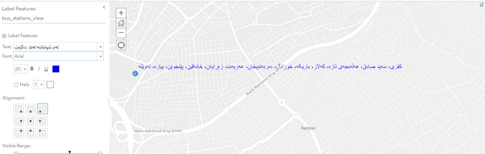

Very frustrating issue, look at the screen shots to see how texts are labeled on ArcPro and Online Web map.
On ArcPro
on webmaps
Tags (1)

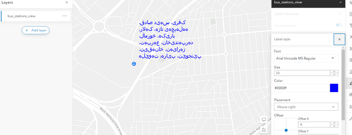

I tried on the new map and new dashboard, the classic map is a bit better, however the classic dashboard has same issue.
nabaz-gharib

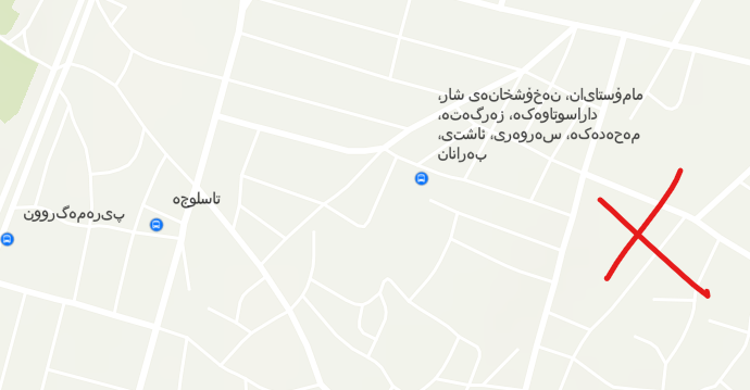

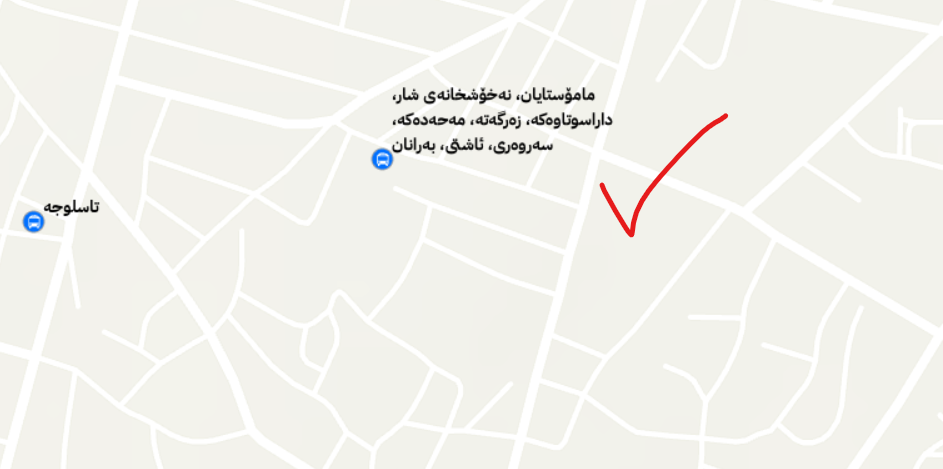

This is the text on the old map
This one is on the new web map; you can notice how the text is rendered on the new web map:

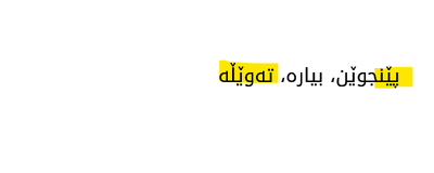

dashboards, both the classic and the new one, have similar issue:
if you look at the highlighted text, you can see the texts, they are not rendered properly, it must look like:

Looking into fonts that could be supported are you able to check your strings with this font:
https://fonts.google.com/specimen/Amiri?query=Amiri+#standard-styles
nabaz-gharib
That font works well, also you can have a look at Noto Naskh, which  supports the Unicode quite well
Noto Naskh Arabic - Google Fonts
