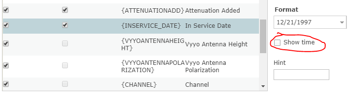

Go to your web map
Go to the feature that has the date field.
Select Configure Pop Ups
Choose the Configure Attributes option
Navigate to your date field and select it.
You will see options for the Date field. Uncheck Show Time
