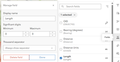

You can format the field in Map Viewer. With the layer selected, click to open Fields, select the field, and configure the settings:

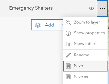

When you publish a feature class, the underlying numeric data type is preserved, but the display format from ArcGIS Pro is not. The best practice at this time would be to configure the field properties in ArcGIS Online, then save that to the layer. That way anytime you add the layer to a map, it will have those properties set.
