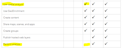

I am studying user types and roles, and came across this. User role can use spatial analysis in ArcGIS Online, but cannot 'perform analysis.'
What is the difference between these 2 privileges?

So, a user role in a web app can rerun the published analysis result in a web app, but can't do an analysis in a web map because that involves publishing?
VickyWang
Another role like Publisher or the role has permission to use Perform Analysis and publish result as result layer in the web map/app. Share the created web map/app to the User role. The User role then use the result layer's run analysis (See the the pdf page 15 ~ ) It's more like pre-configured tool.
It may have other ways to use Spatial Analysis as a User role that I might not knowing. Hope this help.
