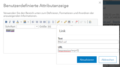

  • Create your Arcade expression. This expression returns the mailto url.
  • note the expression's name, in this case {expression/expr0}.
  • Use that expression name as link url.

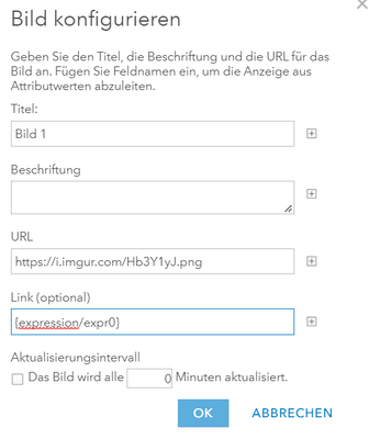

Where to find images:
  • Upload a picture to a publicly available url.
  • Copy the picture's url and use it to insert a graphic into the popup.
