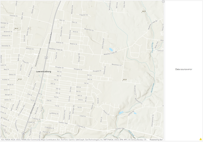

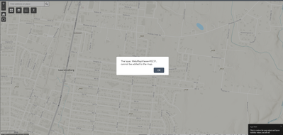

BlakeStaggs13
I am prompted to login and once I login, I receive this error for the dashboard.
The web layer gives me this error
