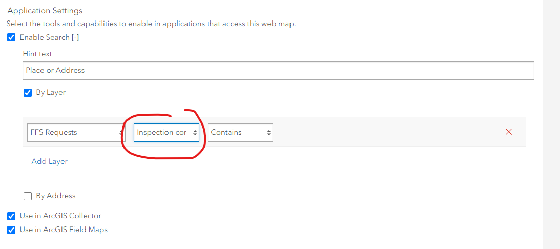

Hi ,
I'm creating a web map that will be used in Field Maps.  I need to be able to search that map based on a point layer.
Some fields don't show up in the picklist to select which one will be used for search.  The one I need is not there...
Anyone encountered this before? Any advice?
Ken
RussRoberts
Esri Notable Contributor
For a field to be searchable and, therefore, appear in the drop-down menu, it must contain strings or integers and not use a coded domain. Integer fields only support the Equals condition. For the best search results, choose a field with unique values.

KenBouchard
Oohh!  This is what it is.  My field use a coded domain...  Thanks for your help.
