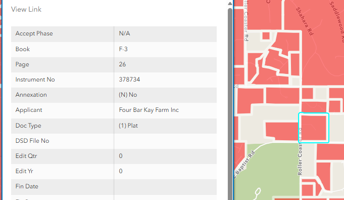

Hello Esri Community!  I am looking for help with a seemingly simple task: within a popup text element, I want to display a clickable hyperlink for a record if it exists.
The closest I have come is using this Arcade expression and text element configuration... however the 'View Link' text shows as un-clickable link if URL not populated; not ideal.
I want the 'View Link' clickable text to only show if link present.  Can someone explain how this can be accomplished?  Thanks in advance!

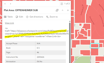

ArthurSmith2
Hi Jon, thanks for your response!
I tried using your Arcade code and unfortunately the Map Viewer isn't rendering as an html link and instead shows the plain text html:
Any ideas to resolve?

KenBuja
MVP Esteemed Contributor
You have to add that code in an Arcade element for the html link to work properly. The code would look something like this (which also uses template literals)
var myUrl = Trim(DefaultValue($feature.ASBUILTS, ""));
var output = "";
if (!IsEmpty(myUrl)) {
  output = `<a href="${myUrl}" target="_blank" rel="noopener noreferrer">View Link</a>`;
return {
  type: "text",
  text: output
