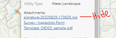

I need help with a custom arcade script in order to provide attachments in a pop depending on file type. I have a JPEG and PDF attached to a Survey123 data point.

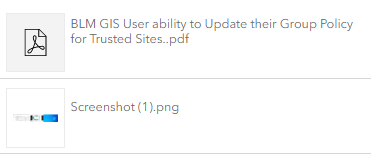

These are the point's attachments. The PNG is filtered out.
