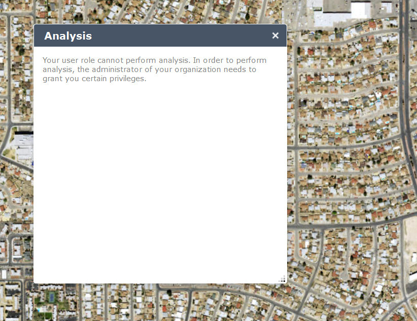

I am new to Web Appbuilder. I am trying to build an application using the analysis widget but keep getting the error "Your user role cannot perform analysis. In order to perform analysis, the administrator of your organization needs to grant you certain privileges."  See picture below. All my maps are currently hosted on a local server and accessible through a web portal. I am the administrator, so I figured I should have full permissions. I read elsewhere that the analysis widget currently works only on ArcGIS Online, is this true?Analysis.PNG

The error message you're seeing is because the account you've logged into Portal as, to create the web app does not have sufficient permissions. The account must be in the publisher role.
You've said you're logged in as an administrator when attempting to create the app, so I am not sure what the issue is. Please contact Esri Tech Support so they can help you investigate the issue further.

Could you check the version of your Portal for ArcGIS? Spatial analysis tools are not available in Portal for ArcGIS 10.3.1 and previous. So the Analysis widget does not work against these Portals. However WAB 1.3 shows the misleading permission message you have got.
If you're using Portal for ArcGIS 10.4 or 10.4.1 and you still meet this problem, you need to be granted specific privileges: Create content, publish features, and use spatial analysis. Some tools require privileges to use GeoEnrichment or network analysis. See more here: Organization roles—Portal for ArcGIS | ArcGIS for Server .
