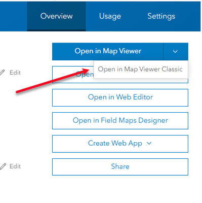

Map Viewer Classic is still accessible, they just 'hid' it a bit.
You now have to view the Map item details first, then the drop-down menu will have the Open in Map Viewer Classic option:
