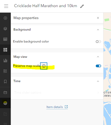

Do you see any layers on the layerlist? I just checked out the map and all the content was loading for me and I didnt see any issues with things being out of scale range.
I also recommend using this preserve map scale so when different clients mobile vs. desktop all open the map at the same scale and if you are using scale ranges on your layer you wont have a case where users on one device see something different vs. another device.

Thanks for the tip on preserve map properties - very helpful!
