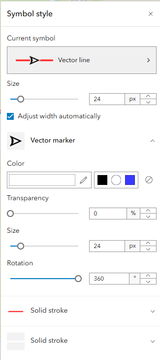

I'm excited about the new features in the October 2025 ArcGIS Online update.  I'm particularly interested in the Vector Offset.  I'm able to turn on and adjust the offset with the provided Vector Lines.

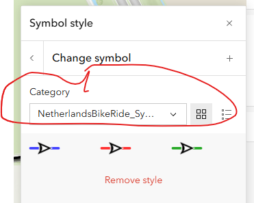

Is it possible to do it with custom line labels that I published from ArcGIS Pro Styles?  The option is not shown as seen in the second screen shot below.  Any suggestions or workarounds?  Thanks.
RussRoberts
Esri Notable Contributor
It is possible if the symbol layer(stroke or fills) has an offset effect. So in Pro if you published this symbol in a web style with an offset effect that isnt 0 (could be 0.001 for example) the offset gets written to the symbol structure and Map Viewer will honor this. Right now if you publish it from Pro with the 0 the effect is getting dropped. We are working with the Pro team to try and get that persisted in this scenario so the full symbol structure gets persisted across from Pro to Web in the web map, layer items and web styles.

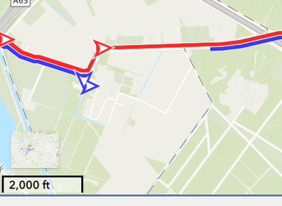

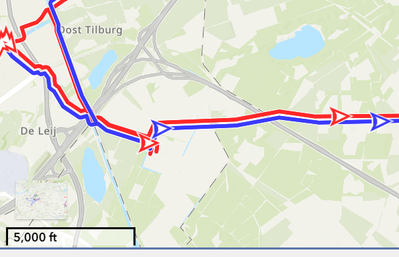

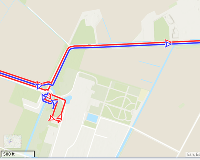

I'm getting the behavior of the offset lines disappearing and reappearing on different zooms.  Here are a few screen shots to show the behavior.  These screen shots are from the map widget inside experience builder but the map viewer shows the same behavior.   I also tried this with a simple line instead of the compound three element of each line shown below that includes the color, white border and arrow and it has the same behavior.  Has anyone tried this and what has been your experience.  Thanks.
Zooming in creates a gap in the blue line.
Zooming further in the blue line reappears

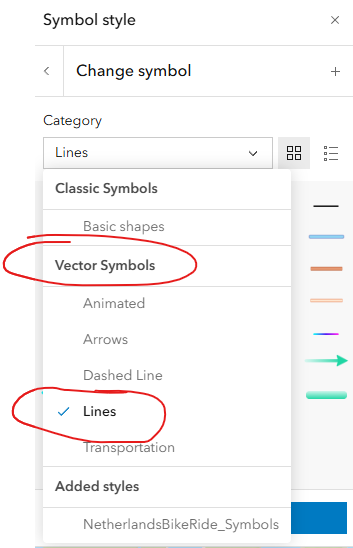

I took the line in ArcGIS Pro Line and published it with offset set to 0.  Then on AGO, I checked the style. The default AGO symbol style was a vector line/Basic.  This default did not offer the option for offset.
When I changed the online symbol to a "Vector Line",  I got the offset option.  THIS MAY BE A NEW BEHAVIOR which I didn't get before. Previously, I had to publish with an offset to get this option.  So this new behavior is good.
However, when I change the offset to -4 I get the following with the gaps and with short lines running across the gap.
Not all the default symbology in AGO provide the offset feature.  For instance the blue gradient with arrow does not.
