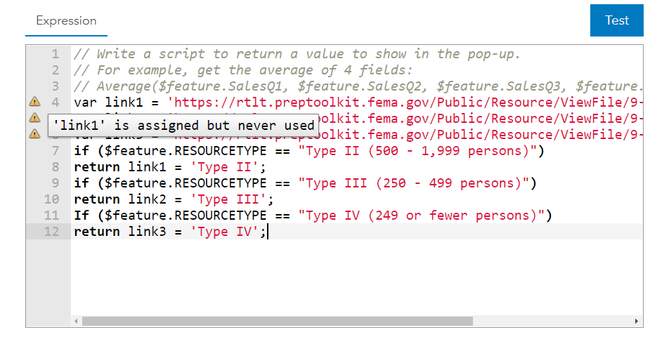

I have written an Arcade expression, it has 3 variables named link1, link2, and link3. When I test it in Map Viewer Classic, it says that these variables are assigned but never used. Can someone assist me in helping determine what is wrong with the syntax of my code? (I also tried the same expression except using Decode with same results, says variable assigned but never used)
var link1 = 'https://rtlt.preptoolkit.fema.gov/Public/Resource/ViewFile/9-508-1192?type=Pdf&s=Name&p=7'
var link2 = 'https://rtlt.preptoolkit.fema.gov/Public/Resource/ViewFile/9-508-1192?type=Pdf&s=Name&p=7'
var link3 = 'https://rtlt.preptoolkit.fema.gov/Public/Resource/ViewFile/9-508-1192?type=Pdf&s=Name&p=7'
if ($feature.RESOURCETYPE == "Type II (500 - 1,999 persons)")
return link1 = 'Type II';
if ($feature.RESOURCETYPE == "Type III (250 - 499 persons)")
return link2 = 'Type III';
If ($feature.RESOURCETYPE == "Type IV (249 or fewer persons)")
return link3 = 'Type IV';

Well it looks like there's some confusion here. First, you assign the value of the three variables. Then, you are re-assigning the same three variables to different values within your "if" statements. I think the error is due to trying to return the variables at the same time as assigning them the new value. I think you need to figure out if you want to return the values within your "if" statements or if you want to return the url's you set as the initial values of your variables. Then, set the values within the "if" statements. When you're all done assigning/setting values, return one item. You can't return all three variables I don't believe.

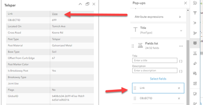

I know that if you use the first one I supplied above that just returns the URL, you can add that as a popup expression, then add the expression in the fields list of the popup.  This will give you a dynamic link that can use variable substitution to create the URL.
My example for testing (data I have), but still just returning the URL itself, not <a href/>:
var link = 'https://mygisorg.maps.arcgis.com/apps/webappviewer/index.html'
var field= $feature.Notes
var newlink = link + field
return newlink
with the value of Notes field being the id (the rest of the URL) so they are concatenated to form final URL.
When added as a field in the popup, looks like:
And when I click on the "View", it opens the dynamically created URL in new window.
But, have not figured out a way, or if it is possible to have the returned link say what you want.  Might be stuck with   "View", but at least you can 'build' the URL dynamically.
