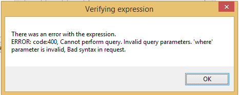

However when using a feature service, my challenge is identifying the table name to use. Below is the actual query being tested by me:
The intention of the above query is to make it show the last record edited. In lieu of the table name, ArcGIS shows a zero (0) instead. I have tried replacing the ? with 0, 1, and the layer name, but they seem to be incorrect.

Turns out that subqueries as part of the where clause is not possible in this scenario. ArcGIS Online only allows standard queries.
