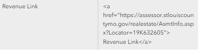

Thank you! However, when I try that, this is the output I get:
__JackCharde__
Are you calculating a new/temporary field on this dataset? Are you using a popup with multiple content types? I'm thinking you may need to put this in a text content type so the html renders properly.
