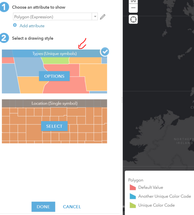

From the sounds of it, you're using the ArcGIS Online map viewer to render your layer's symbology?
When you've configured arcade expression, you can define the colours through 'Select a drawing style' instead of the expression yourself:
If you've already tried this, did this not meet your needs?
Carmel

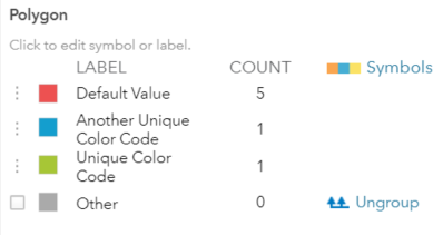

Arcade does not be allow you to define the fill colors of your polygons. The expression will only return in this case a text  that you can use to define the symbology for your polygons using standard smart mapping. You can define colors in pop-up windows or labels, using the expressions, but not for symbology.
Arcade is based on JavaScript (it is an extract from JavaScript with some additional functions). An expression defined for one layer will not be available for the other layer and even when you copy the expression from another layer, you will still have to modify the symbology for each item.
You can however create the expression and symbology for a single layer and use ArcGIS Online Assistant  to apply it to the rest of the layers editing the json of the web map (this is a bit tricky!). Example expression:
var bio = $feature['BIOSECURITY'];
var pip = $feature['PIP'];
var result = "";
If (IsEmpty(pip)) {
    Console("PIP=?");
} else if (pip == 0) {
    result += "PIP:NO";
} else {
    result += "PIP:YES";
If (IsEmpty(bio)) {
    Console("BIO:?");
} else if (bio == 0) {
    result += "  BIO:NO";
} else {
    result += "  BIO:YES";
result = Trim(result);
if (result=="") {
    result = "No Data";
return result;
This will yield the following options, here shown in the legend with a color applied to each item:
In AGO assistant you will have to copy the entire layerDefinition section of the layer and insert it in the definition of the other layers. Be aware of creating an invalid json and do this preferably on a copy of the web map.
