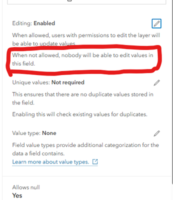

did you try this one:
In AGOL go to the data tab, click fields, select the field you want to restrict.
