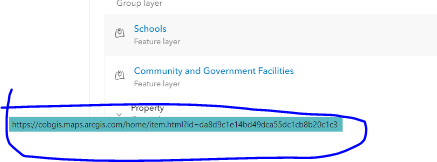

Now, the problem. I'm creating a new webmap in dev but saving each feature layer as an item. Doing this mainly because we can store credentials for secured services with the item, thus eliminating the need for staff to sign in to the secured service (also, it seems Esri is recommending this pattern, as a better approach to creatign webmaps - I saw this I think in a blog post, but not finding it now). So far, so good, but when it comes to updating the test webmap, the AGOL Assistant 'Update URLs of a Webmap...' tool can't be used because the webmap now references a bunch of items, each with it's own random alpha-numeric item id. Since there is not pattern to these IDs, there is no easy way to automate updates\migrations between environments (no search and replace capability).
