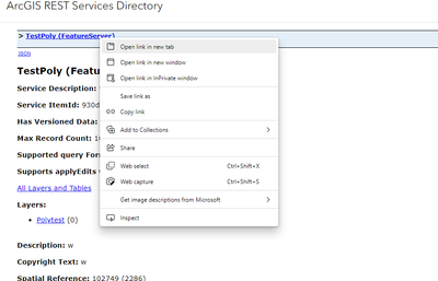

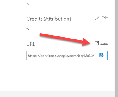

Try this route.  Open the item details page and click on the View link at the URL:
Then, right click on the new link that comes up and open in new window or tab:
This will actually take you to the REST server with the token in the link.  There should also be an Admin link in the upper right of this page if you need it.

MelissaGearman
Thank you Rhett! This worked!
